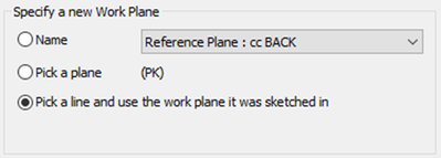

The Work Plane option provides some extra flexibility. There are 3 options when selecting Work Plane. Each one of these options has it’s uses and shortfalls.
  • Name – Places the connector on a named Work Plane.
  • Pick a Plane – allows the user to pick a face of an object to specify the Work Plane.
  • Pick a Line and use the Plane it was sketched in – allows the user to pick a line to specify the Work Plane.
Name-based placement works when using Reference planes to constrain the family. Once the reference planes are named, that Reference Plane will show in the dropdown list. Select the Named Reference Plane from the list and the connector will be placed on that reference plan, intersecting the Center plane

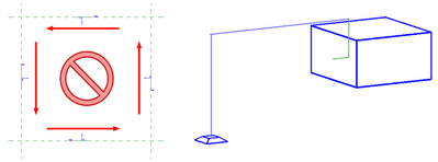

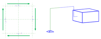

Now for the catch… for the connector to be placed in the correct orientation to receive a Pipe or Duct, the reference planes must be placed the correct direction.
  • Placing the Reference Planes in a Clockwise direction orients the plane to place the connector in the outward facing direction.
  • Placing the Reference Planes Counterclockwise will result in the Connectors placing Inward.
Unfortunately, when a connector is placed by the Name option, the connectors front/back flip arrows don’t function. If a connector is placed on a reference plane and the connector is going the wrong direction it can be fixed though. An easy fix is to select that reference plane and pull the end grip across, and past, the other side. This will “flip” the reference plane direction, and the connector.

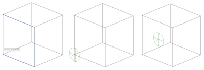

Pick a Plane works similar to the Face option. The advantage is, once placed the connector can be moved similarly to the Name option.
  • Select a face on an object
    • Use the Tab key to cycle between faces if needed
  • The connector will place in the bottom right hand corner of the face
  • Select the Move command to move the connector anywhere on the face.
  • Similar to the Face placement option, temporary dimension can be made permanent and parameters can be applied. This will allow the connector location be adjustable.
Pick a Line and use the Plane it was sketched option allows Revit to create a work plane based on the line selected. The Pick a Line option works with Model lines, Symbolic lines and Reference Lines. This option does not work on modeled elements. The catch is you usually don’t know what plan the line your selecting was drawn in.
