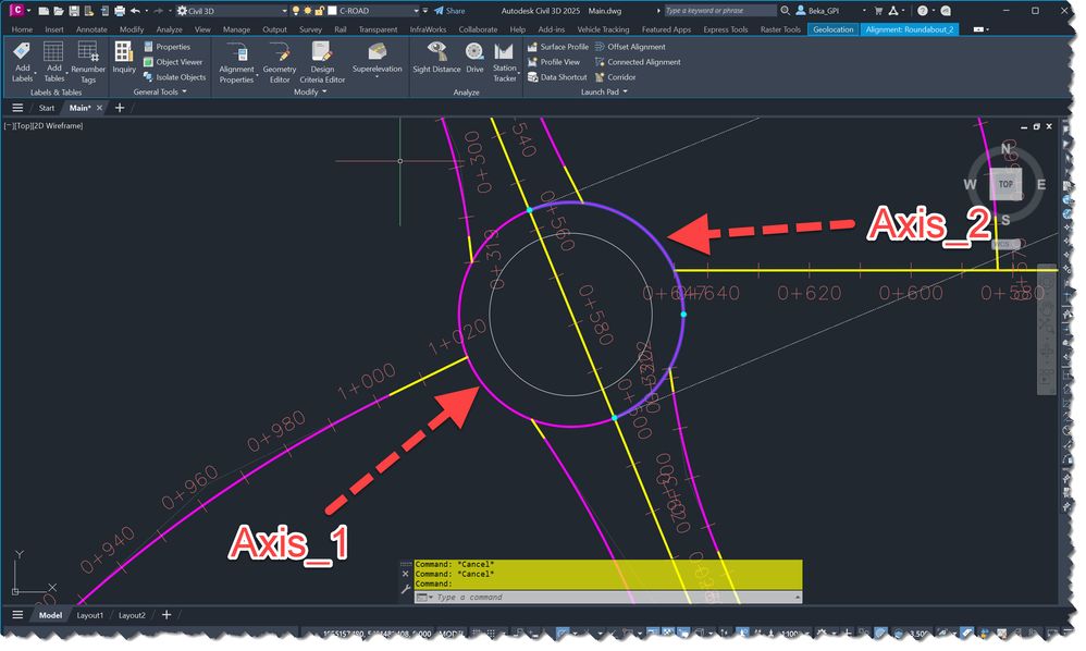

It is better to split roundabout alignment into two separate alignments, sometimes a single rounded alignment does not import properly in InfraWorks.
Export .dwg into .IMX
