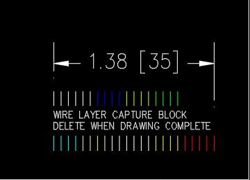

The screenshot below details a dimension and multi-colored wire naming convention block.
The dimension style in this example has been set up to company standards. By having a dimension present in the template, its style will be included with every new drawing created from this template. Consistent dimension style from job to job is a critical part of a quality drawing package, a key deliverable supporting products the company ships.
Also shown in the screenshot is a detail with ACADE wire layer examples. Matching these settings to company standards is another essential quality item, even if not apparent in the printed drawings.
