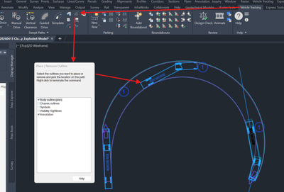

I'm not seeing it. I don't even see the Position Vehicle dialog in 2026. I want to drive the vehicle on the path similar to how Animate does, but under my cursor control. Then have it freeze at certain points along the path and leave a copy of the vehicle showing its articulation at that point.

@dbanaszak If I understand you correctly, this might be what you're after:
