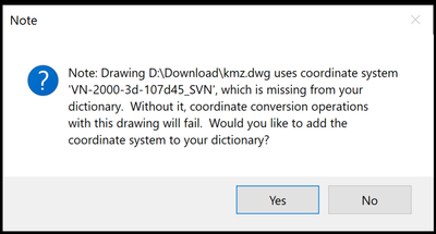

As i  mentioned, there are some strange line appear when i export this particular polyline to kmz. I had attach the dwg contained the polyline that cause the problem. I dont know why it behave like this, how can i fix this?

I'm guessing the problem is your custom coordinate system. I wasn't able to export to KMZ, or even use Bing Live Maps. I get "No geographic location defined."

namlt33
https://drive.google.com/drive/folders/16x2tnmYDObc1pfm6QXuTvLL_0TMkKE50?usp=drive_link
Here is my custom coordinate system files, pls take a look and let me know if you can export the kmz

I'm not able to create a KMZ from your drawing.
Have you searched EPSG for coordinate system definitions?

Civil 3D already has the Vietnam2000 Datum and a Vietnam2000-to-WGS84 Geodetic Transformation.

You custom coordinate system is the problem.
Would it possible to put your line in a known coordinate system, not a custom one, then upload it?
Also, your uploaded drawing doesn't look reliable due to your 'custom' coordinate system. Any efforts to transform your drawing will likely give bad results because the transformation will continue using that bad projection. Your issue could be x,y coordinates. You might have flip-flopped them, treating the X as though it were Y and the Y as X.
Did your original drawing use Geographic Coordinates with Lat/Long degrees? Or did it use Projected Coordinates with meters? Whether your original data uses degrees or meters may help in resolving your issue.

Hi everyone, my location is South of Viet Nam (Vung Tau City). Anyway i figure it out that the System coordinate is not the issue but the nature of the polyline it self. I have try to export it in other coordinate systems and the result get very similar to the image @Pointdump had attach. Some part of the polyline is made of an arc and those  will create a long line when exporting to kmz

1. with the provided coord sys it came out on the south pole or something
2. the polyline had properties like "global width", and that's also an issue.
3. so, i "cleaned it up", no segments were deleted or converted, assigned the Vietnam lat long coord sys, and presto.
