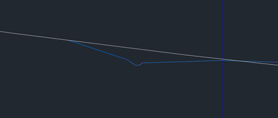

Hello @nkiakas ,
In my project, I must provide drainage on both sides of the road. But the condition is , at the embankment section drainage should locate at the point where my design profile and ground level meet so that water accumulated from the ground surface didn't enter the filling material from the sides slope, and for the cut section it should locate at the end of shoulder.
In above figure white line represents the ground surface and blue line represents the design profile, verticle blue line is center line. This is the embankment section and the drainage should locate at the point where ground profile and design profile meets not at the end of the shoulder, as shown in fig.
This figure is the cutting section. The drainage in this case is ok.
Now my problem is how to design such a conditional assembly so that drainage is locate at the point where ground and design profile meet in the case of embankment section and drainage locate at the end of road for cutting section.

Hi @sameerdhungana96
Maybe you have to add a decision tool to check the fill (embankments)/cut not in the center line but a point in the drainage channel (look the red dots in the attachments)
Regards
sameerdhungana96
@nkiakas how to add a decision tool? I cant find any tutorial or guide on the internet regarding the decision tool.
nkiakas
The decision tool works like IF check something. In your case check if the point is above surface. THEN if the check is TRUE then its fill condition. if is FALSE is cut condition.
For the checking inside the decision tool, you have to use the function DistanceToSurface(surface target) from the points class. If the distance is positive, the point is above surface. If the distance negative, the point is below the surface.
