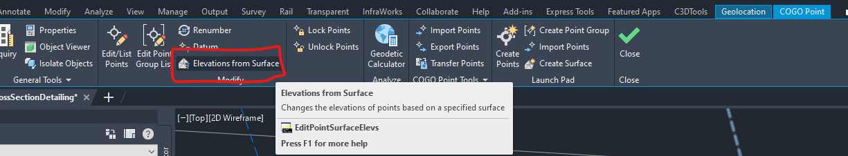

Chris, I select one of the points and when the new tab for Cogo Point pops up then I go to Elevation from Surface icon, then change all the points by group and then I have the as-built points but in design height, then export them and do the calculation in excel as no I have 2 sets of points, one in as-built height and one in design height but in same coordinates.

Thanks for that, in civil 3D itself you can simply change point height to surface heights and export it to CSV and compare. What I wanted was an automated way of doing this without using a third party. I wrote this plugin attached which does this.
