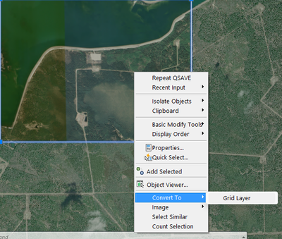

hlimCSSAB
I have been struggling with this problem and somehow encountered a solution.
Right-click on the ecw image and select convert to grid layer and it worked for me!!!!
Idk if it was just a coincidence but I hope this can be helpful.
Message 9 of 9
plantpower
I have no idea why this worked, but it's literally the easiest solution.
