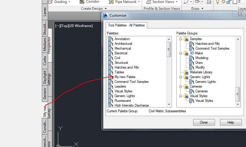

Let's try this way.
1. First install your tool palette.
2. Open the tool palette.
3. Right click and choose customize palette
4. Go to your tool palette
5. Right click and select export
6. Then close the dwg.
7. Reopen the dwg. As you say now you don't have your tool palette.
8. Just create a new blank palette to with the name of your old palette
9. Follow option 3-4 and step 5 use import instead of export.
