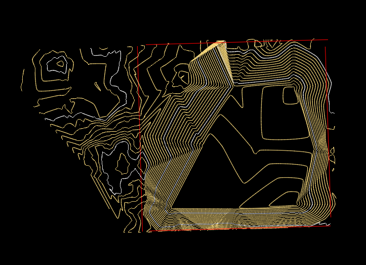

For context, I am including the plan view and a couple of the sections. They are removing gravel and filling this area with reclaimed overburden using the 20:1 and 3:1 slopes to the top of the previous gravel/sand layer.
I appreciate your detailed instructions.
Cheers,
Liesl
Message 6 of 29
Hi and thank you for your reply.
Here are three images to show what we are trying to accomplish. The original ground surface was modelled from survey data, but the sections (A, B and C) were drawn manually based on specifications.
Now, they want me to recontour the "reclaimed" surface (sand & gravel layer removed and filled with reclaimed overburden.) Had I known this from the start, I would have attempted this as part of my section drawings but these screen shots will hopefully clarify.

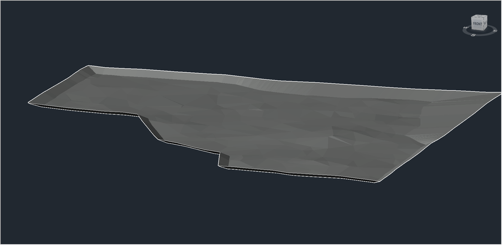

I will try and explain the above with images here:
  • Grade the feature line (Infill included) that defines the gravel pit extents.
    • Note that when grading internally with flat grades/slopes to curved sections you might get some issues, rather have sharp corners for these scenarios.
    • Remember to have a surface (name: Bulk Cut) automatically created for the grading objects.
    • This grading was targeted to the Bedrock surface.

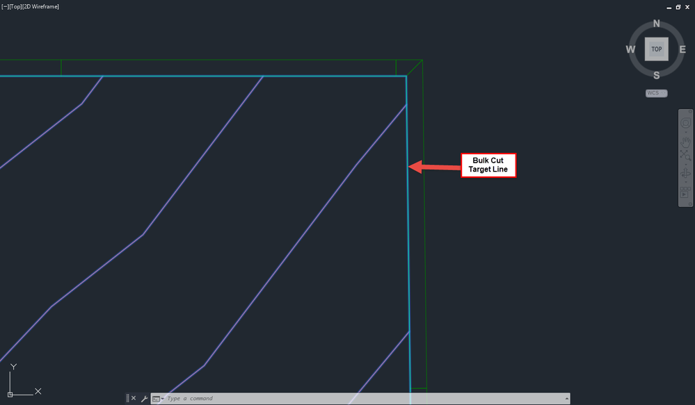

    • The grading was set to 0.1:1 to achieve a near vertical cut.
  • Create a blank surface and rename to Base Surface.
    • Paste the Bedrock surface into its definition.
    • Define the target line of the graded surface as the outer boundary.

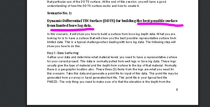

DDTS method to create strata based on bore holes might be helpful
Joe Bouza

I am a fan of DDTS. I do not think is is helpful in this situation.
Since there are multiple bore holes a single depth, or average of depths would have to be used. From the profile provided by OP, the lower strata do not look to be parallel with the EG. By definition the DDTS surfaces will parallel the  surface that they are built from.
I admit that the Sand and Gravel volume calculated using average depth DDTS will be close to the volume based on boring log point based surfaces, and may well be within acceptable earthwork accuracy limits. In this situation, using the boring log information does not seem to require excessive effort, but does eliminate questions.
The Geotechnical module may be helpful, but I am not at all familiar with it.

My method would have created BED by adding points that were at the bedrock elevation.
The DDTS would have created points at depth, and used these points to create DepthToBED surface.
Paste EG surface into BED surface, then paste DepthToBED surface into BED surface. Should get the same surface within the area defined by the bore holes.
Can you post a link to the article you referenced. I have not looked at DDTS in this way before.

All I really want to do at this point is to create new contours of the reclaimed overburden.
I created a new surface using the elevation points of the original ground for the outer edge, and the sand/gravel elevation points for the inside from the test hole data. This is what the surface looks like:
Now I want to slope the west side down to the surface at 20:1, and slopes from the north, south, and east at 3:1 using the red lines below:  (these are the permit boundaries)
As you can undoubtedly tell, surface modelling is completely new to me so even making a feature line was a big deal. Most of our work uses Map, not Civil so I apologize for my ignorance.
I have now created a feature line of the west red line from above using the surface I created of the "overburden" layer, which is the top of the sand/gravel layer: (This surface is called overburden)
I have associated the elevations of this feature line with this "overburden" surface.  My next step is to project this west feature line at a 20:1 slope to the "overburden" layer. I would repeat the same step with the other three lines, except they are at 3:1 slopes. From what I understand, I should use infill for the corners. @Apex-Solutions mentions creating automatic surface for grading objects, which I think I know how to do - it is the difference in slopes (20:1 on one side and 3:1 on the others) that is giving me trouble.
Is this correct so far for what I am trying to achieve? I have tried to follow all the excellent instructions closely and honestly getting lost as the authors assume that I know some of the processes already.
