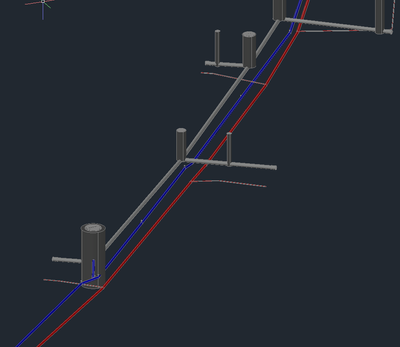

I am trying to export "pipes" and other structures (from Civil 3D to IFC), which are in general 3D Solids or Block Reference.
I am constantly having this issue, that IFC geometry is incorrect. In the first picture you can see it. Second picture is how it looks in Civil 3D, and the last one - I moved whole project to wrong coordinates to somwhere near zero coordinates, and IFC is 90% OK.
I tried exporting with Civil 3D 2023, with Civil 3D 2024, COPY - PASTE to New dwg files and so on.
FUN FACT - Trimble Connect shows IFC with correct geometry, Autodesk products and ArcGis do not.
Any ideas?
Incorrect geometryIncorrect geometryCivil 3DCivil 3D90%_correct_geometry_but_wrong_coordinates90%_correct_geometry_but_wrong_coordinates

Are you opening your file in Navisworks?
Might have something to do with large coordinates.
Try following settings under options:
alekseikN7NRM
Navisworks was used only to show, that IFC geometry is incorrect. My aim is to add this IFC with extended data to ArcGis. Reason why I need IFC, is because in DWG attached a lot of useless information, while IFC is +- clean.
