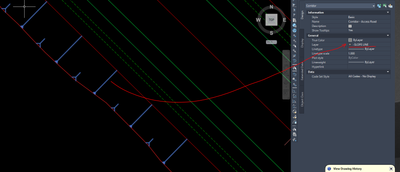

teerawat.pSCHYQ
@jan.krawczeniuk   sound good if you following way as @ecfernandez  mention.
anyway, in your corridor, you can press  "Ctrl" button on keyboard and then select your slope pattern that you add in your corridor, then in the properties you can change the slope pattern to any layer what you want. like this.
