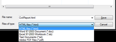

Jay_B
Depending on the report created, there may be an option to specify report output file type on the "Save As" dialog.

Jay_B
Have you tried changing the output file type at the bottom of the report Saveas dialog box?

tmachado
I have no problems,  saving this report as a word doc in C3D 2018 or C3D 2019
