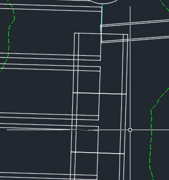

I have a 72" underground retention system with a header pipe.  When I connect the pipes to the header with a null structure using the ODOT pipe network setup and set the null structure to No Display, the pipes appear to connect to each other.
However, when I put the same pipe network into my company standards settings and set the null structure to No Display, the pipes will not connect.
What setting do I need to change in my company standards to make the pipes appear like the ODOT pipe connections?

Stab here: Is the pipe end set to off in the pipe style?
Option B: set the nulls to no plot instead of no show

Pipe ends are turned on in both scenarios.  Turning the pipe ends off did not help.
If I set the style of a null structure to something other than no display, it doesn't affect the way the pipes look.  Furthermore, the ODOT network is working on No Display and is working the way I want.  There has to be something else that makes it work.
dbriden
I've figured it out.  Edit the pipe style.  In the plan tab there is a box to "Clean up pipe to pipe connections".  That did the trick.
