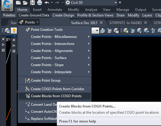

AllenJessup
in reply to: 654work
It's not perfect and will not include marker blocks. But this will create blocks from the points.

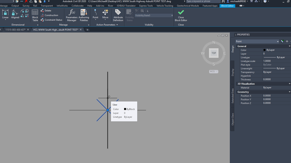

m_kingdon
Not entirely sure of the issue, but you could enter the block editor and insert a point in the block, next save and explode all the blocks which will leave lines and a point in the exact position?
