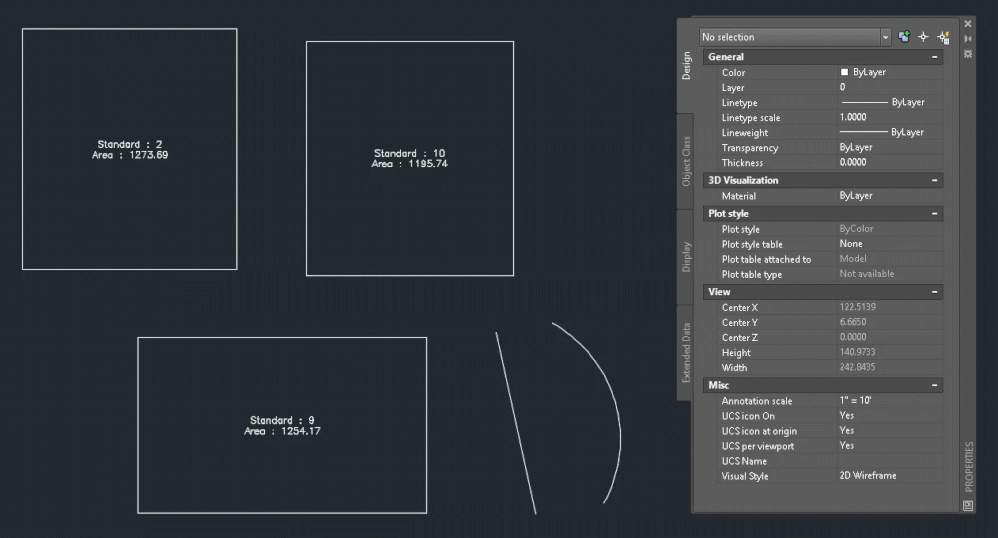

Is anyone else seeing really slow selection times?
I'm in the early stages of a new +/- 900 lot residential subdivision, doing the typical swapping of this size lots for that size over there, etc in client fashion, and I literally timed it at +/- 3 seconds to select a single Parcel with Properties Pane open (before a Select Similar to get a resultant count).
Not sure if it's an issue with Civil 3D 2018.1 as this is the first time I've used Parcels in 2018 (this is my pilot project), or not - I have also just recently installed Windows Fall Creators Update, but nothing else seems (no other application) to be having an issue at all.

Your post #19 is still spot on here, using C3D 2019.2+... Nothing's seemingly changed but the date.
I select a single C3D Object/Label with Properties open, it takes +/- 3 seconds for Properties to populate and cursor to be usable again, which makes attempting to rapidly select a sequence of individual C3D Objects/Labels a PITA.
By comparison, attempting same with vanilla AutoCAD Objects (even in C3D) is near instantaneous.

I must be doing something wrong... Here's a quick GIF of how slow Civil 3D 2019.2 is at selecting a small Parcel in an empty drawing:
I'm two doors away from the file server in our SMB office, running a workstation with Win10x64 Enterprise (configured for best performance, 65536 MB Page File), 4.2 GHz Core i7-7700K CPU (w/Turbo, OC with Intel XTU), 512 GB Samsung 970 Pro NVMe/M.2 SSD (over provisioned), 32 GB DDR4 RAM, 8 GB NVIDIA Quadro P4000 GPU, 3x Gigabit NICs w/SMB3, with all of my CAD-related support files and temp folders located on a +/- 9000 MB/s RAMDisk (yes, that's a big B; at Seq Q32)... I kind of feel like 'slow selection' shouldn't be an issue for me. Haha
[Edit] - I just tested this again after turning off Graphics Performance and have the same lag.
[Edit] - UserBenchmark workstation score from June 2018 (is UFO good?): https://www.userbenchmark.com/UserRun/9215448

Following the 'I must be doing something wrong' premise, I've precluded ALL customizations from loading (Autoloader apps, acad.lsp, acaddoc.lsp, disabled all reactors, etc), loading the OOTB <<C3D_Imperial>> Profile & DWT (all on C: drive) and even repeated this attempt using clean screen, closed ribbon, etc... So Properties palette is the only thing 'open'.
In the GIF below, I cannot even hit <ESC> until Properties is done populating, to attempt to quickly re-select a Parcel the way you showed is possible.
This is no different (albeit for me) when all customizations are loaded and the same behavior I've experienced since 2017 (which we skipped, only I tested it) & 2018 versions which is when I reported this.
I'm at a loss... Any suggestions at what to even look into at this point?
