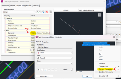

I'm finally back into a project with an alignment and labels. I'm using 2024.0.1 and have to constantly do a REGENALL multiple times just to get labels to show up.
I know there's a 2024.2 update, but it had issues when released I won't install it until it's more widely available.
This happens with alignment station-offset labels as well as the station label group. I have to zoom to the paper extents and do a REGENALL in order to get them to show up. Sometimes that doesn't work and I have to switch to model space then back to paperspace just to see my labels. AECCVIEWPORTOPT=0 and the status bar icon are turned off and it still happens.
There's also a problem with the alignment stationing labels looking different. The stationing labels that are on the curves are more bold & larger than the tangents. It's the same station label group, so why are they different?
When I opened the label editor I noticed that the font it was using wasn't what the text style is set to use. C3D 2024 seems to always have an overridden text style that cannot be removed even when right-clicking and selecting "Remove Formatting?"
When I changed the font here to be the same as the text style of "RomanS" that seems to have fixed the different size text and font for the curves. But why did it happen in the first place? Even the color aspect here doesn't seem to work properly. Why does it still show "\C256;" before the contents of the label even though I've hit "Remove Formatting" multiple times? What is color C256 anyway? I think C3D's label system is using a true color instead of the index colors even though the dialog is showing index colors.
This entire new "feature" has been a disaster that hurts productivity. Something's been broken with the label editor for a few versions and it hasn't been fixed.
