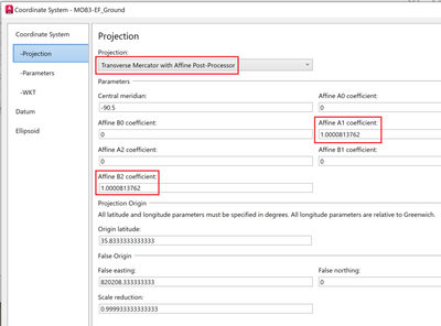

Correct I made a duplicate coordinate system with my ground scale factor. When I did that the aerial and survey went from only being a few feet off of each other to about 30' off. I believe I did all steps correctly. Attached is a screenshot of my settings for the duplicate system. The ground scale factor is 1.0000813762. The three items I changed in the duplicate system are highlighted in yellow. I took the original values from the original coordinate system and multiplied them by my ground scale factor. I can't attach the Nearmap but the MSDIS comes in at the exact same location. It is linked in message 3 and is named "Jefferson.zip". It is too large to attach here. The example survey file is attached there though.

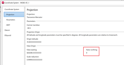

I've watched Alan Gilbert's video, and am chewing on it. Maybe that's the right way to do it, but I've got doubts. The 0 False Northing bothers me. I'm going to experiment with a couple other ways.

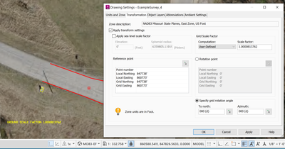

Here's a different way. Duplicate, then edit, MO83-EF. Change it to "Transverse Mercator with Affine Post-Processor".
I had to use Raster Tools IINSERT to bring in the image. MAPIINSERT won't transform to the custom projection. You could also use MAPCONNECT.
ExampleSurvey_3 attached.

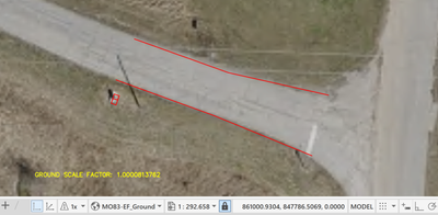

So I use Data Connect to bring the image in. The first screenshot with the red circle shows how the aerial comes in with me using the standard MO83-EF coordinate system. You can see it is shifted at the red slabs by about 2', like yours.

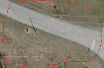

If I use the duplicate coordinate system according to that youtube video, I get pretty much the same result, still shifted.

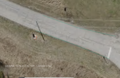

I tried doing the version you just showed with the affine and it still comes in at the same spot with a couple foot shift.
It seems that no matter what it is either that 2' shift off or 30'

Keep in mind the image might be off that much at that particular point. Or the linework might not be dead on.
The Transformation Tab is probably your best shot. You can bring in your imagery with either MAPIINSERT or MAPCONNECT.
Drawing ExampleSurvey_4 attached.

 As @Pointdump  has mentioned, the aerial photo can be off. The photo is not gospel.
If you want to get it accurate, get numbers, such as numbers expressed in geographic Lat/Long or some other projection, e.g. a series of points consistent with 'edge of pavement' and individual points for telephone poles, electrical boxes, fire hydrants, etc.  You can connect dots in AutoCAD. Substituting an aerial photo for coordinates is risky especially when high precision is needed.
In your specific example, you can ignore the scale factor and use MO83-EF in your drawing.
