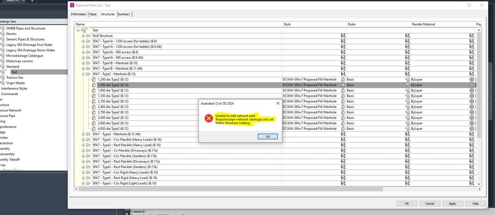

I've attached the images here from Part Builder, as you can see the parts are in there and indexed. But when creating the part in C3D again they come in fine. But C3D does not allow me to draw the pipe, in the parts list they are all there, I have a feeling it is something to do with mapping the parameter.
Message 4 of 11
dave.middleZX7S8
These are the images of the pipe being imported to C3D
