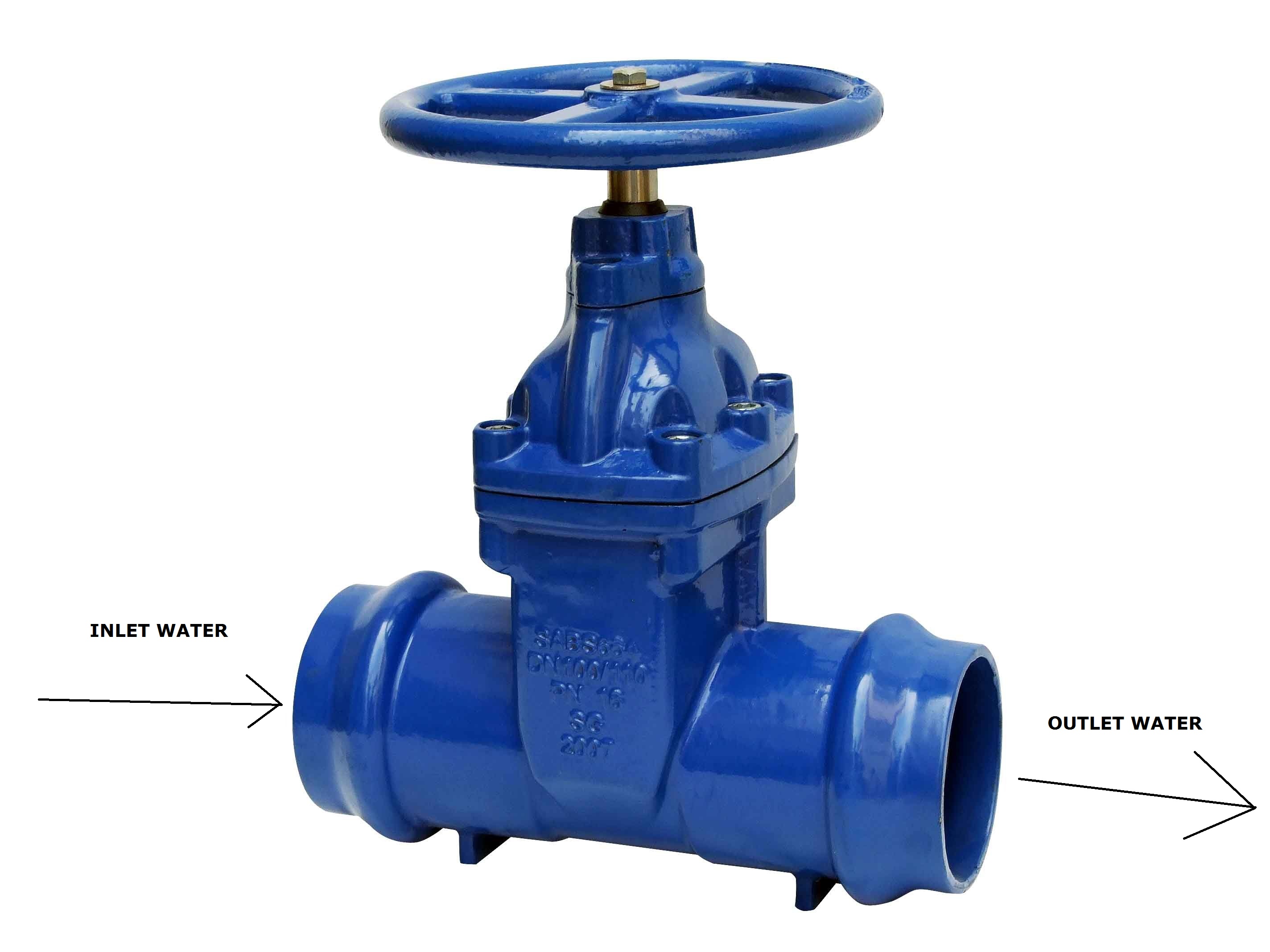

Dear Mr Jon Wilde,
I had designed a part, like picture below. And I want to reduce the Volume Flow Rate from 10-20l/h to 1-2l/h by a narrow way for water. But in Simulation I still got outface water have a same Volume Flow Rate with inface water. Can you help me to explain why and how to fix it?
Here is my CFD file: it 13Mb, I can't upload to this forums...http://www.mediafire.com/download/mk7tu100ttgds97/TEST+PART+CFD.cfz
AND the narrow way for water
I have attached my DWG file design and my CFD Simulation. If possible, pls help me to understand why the Volume Flow Rate isn't change . Many thanks and Best Regards.

This is conservation of mass right? So unless your density changes, the flow rates must be identical?

i think i understand what you mean. Because I set a fix inlet flow, so whatever narrow space inside my part, I always have a same value outlet flow, equal with inlet flow right?
Thanks but my question now is : if my part is a valve to control flow of water, I need to know how it work by compare value of flow inlet and outlet of part. In Autodesk Simulation CFD, how I simulate it? Can you teach me to set inlet value?
Suppose I have a constant value of Velocity, or Pressure inlet water, how I set it in Autodesk Simulation CFD to compare the value flow outlet?

If you have an incompressible fluid (you do) and a fixed flow rate, the inlet and outlet are going to be the same. Changing the geometry will change the pressure drop though.
If instead you set a pressure drop to the model higher at inlet and a P=0 at outlet, then CFD will give you the flow rate this would produce. This would change depending on the geometry.
I would use Advection Scheme 5 for all of these. Be sure that you have inlet and outlet extensions also (5x diamater on inlet and 10x on the outlet). This is to avoid recirculation over the boundary, which can negatively effect results.

     Let me take a large step back as I don't believe you are taking what Jon is stating in to consideration along with the practicality of the examples you are referencing.
As Jon is stating, there are basic prinicples that we cannot create or destroy mass, so for any valve, pipe, etc if we are using constant properties (fixed density) then we will get the same flowrate in and out of the system. This is good and to be expected.
What you are referencing as far as how a valve works (in a toilet or for your garden), is there isn't a prescribed flowrate at the inlet.
The way all of those systems work is that there is a fixed Pressure upstream. (P1)
By opening your valve you are changing the pressure drop of the system to the outlet P(2)
So as the Pressure drop changes (due to opening or closing the valve) you will get more or less flow.
But to circle back to the comments made - at any point in this example when you open the valve there is exactly the same flow going in to that valve and coming out to conserve mass.
For your analyses there are two approaches most people will take:
1) Set it up using Prescribed pressure drop (High Pressure on Inlet - Low Pressure on Outlet)
    As you change your valve position you will see the resulting flow rate that corresponds to the valve position
2) Set up as you have done with a Flowrate at the inlet
     Here, as you set the flowrate and alter the valve position the Pressure response will change. At the end of the runs you would then compare the pressure response to whatever the known source pressure you have for the design you are working with.

Hi Hoang,
We run models like this every day, no problem 🙂
Set a model up like this:
Inlet = 0.5bar
Outlet = 0bar
Use Advection Scheme 5
Run this to convergence - this is enough iterations for CFD to automatically stop when it has a solution.
Place a cut-plane through the cross section and measure the flow rate. Of course - if your pipe is not long enough, the flow might still be developing before it reaches the outlet even, another thing to consider.
Once you have done this, right click and clone the scenario.
Change the inlet pressure in the new scenario to 1 bar and run again until convergence from 0 iterations. Measure the flow rate.
This would demonstrate a difference in flow rates. Provided of course we are not causing some compressible flow 🙂
Check your mesh quality too - we need a minimum of 4-5 elements across the pipe diameter (not including the boundary layer). I would say that it might be better to aim for 10 even.

1) Yes, just set a pressure drop or you will be overconstraining the model
2) Just run to convergence, start with about 500 iterations (it should auto stop in less)
3) Use the Bulk Calculator
