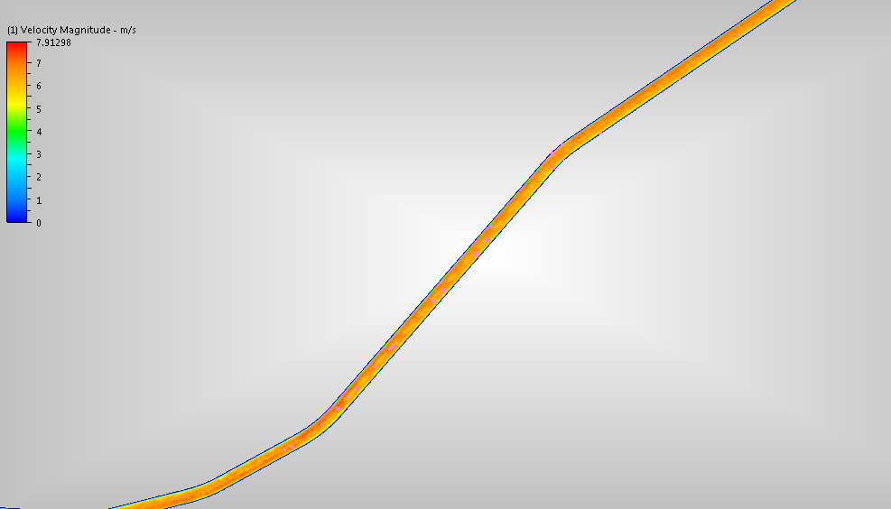

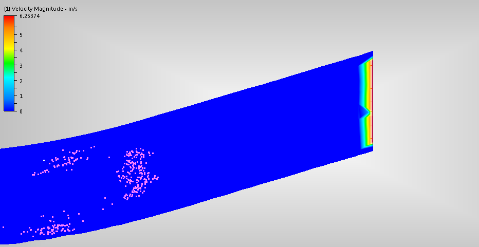

as i said before, the goal is very simple. i just want to know the accurate velocity in some points. i want to see the influence of gravity accelaration
Then, i'm getting confuse with the result. this is the image of inlet, -the rest of velocity contour is blue-
what setting that i missed, would you like to share with me what geometry, boundary condition and etc that i have to set to run this simulation. thank you Jon.

I would say because this was run transiently for a second of real time 🙂
Lets start simple and add in gravity for a second run.
I would expect you to have either a high pressure or flow rate at the inlet, correct?
A P=0 at the outlet too.
Run steady state for 500 iterations and see what the results look like.
Advection scheme 5 (as per the page I shared) is likely best suited (solve ->solution controls->advection).
If possible, run a geometric 1/2 model rather than 2D which I agree isn't so sensible here. Takes half as long or you have scope for a finer mesh.
Can you shade the cut-plane by mesh so that we can see what it looks like?

i set P=0 at the outlet and Vx = -5,98 m/s, Vy = -1,83 m/s at the inlet. I used free surface because i want to enable hydrostatic pressure/gravity as your advice. although there is an initial velocity, the flow is driven only by the gravity. so i think there is an increasing of velocity because of accelaration.
then, i did your advice to use steady state condition. adv 5, etc. but i couldn't see the change of velocity contour significantly. the contour change significantly only in the beggining of flow.
then what should i do?
Thank you very much

i'm sorry Jon. this is the second run, after adding gravity.
what do you think?
i still see a bit strange result

It's hard to tell, what looks wrong to you?
How does the mesh look?
Are you using the standard transient settings once you have enabled the free surface?
Jon
