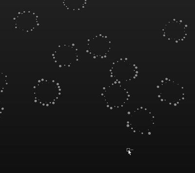

I have an island of points.  In Maya, if I "shift>", I can expand my selection.  After repeating "shift>" a few times and deselecting my original island of points, I'm left with a ring of points.  This is what I want.
I see "get_points_in_radius".  That appears to return locations (not what I want) and point indices (what I want).  And there's also "sample_closest_in_radius_accelerator" which only returns point indices.  In either case, if I feed in my island of points, just using a radius will mean I will have to exclude my island points from the resulting indices.  Which way is the most efficient for what I want to do?  Is there another option I'm not aware of?

"get_points_in_radius" took awhile but I got what I wanted.  I couldn't get the "build_closest_accelerator" to work.  How do I set the geo component to points?  I left it blank and maybe that's why I'm not getting anything.  I would like to speed up the graph so maybe this accelerator is the way to go.  Just need to know how to set the geo component.  Help?

Now that I have my indices from "get_points_in_radius", this also contains indices for the original island of points.  I tried "remove_from_array" to remove the original indices.  But nothing happened.  My point scope is still showing the results from "get_points_in_radius".  I was expecting to get a ring of points around my original island.  What did I do wrong?

So geo component should be set to "point_component".  Much faster than the "get_points_in_radius".  Still don't know why I can't remove my original array of indices from the resulting array of indices.

I just noticed that the point index output type of both the "get_points_in_radius" and the "sample_closest_in_radius_accelerator" are "array<array<long>>".  Why a double array?  Now this propagates throughout my graph.  Is this why I'm not getting what I expect?  How do I convert this output to just "array<long>"?  Or do I need to?

I tried connecting the resulting point_index to my output and then printing the values.  And found out that it's a "compound with mixed type elements"!  Is this why I couldn't use "remove_from_array" to get the indices of only the ring points?  How do I convert this compound output to something useable?

sepu6
Is this what you want?
Message 10 of 14
mcw0
I was able to get as far as what you've shown.  What I want is to subtract the starting island of points and end up only with the ring.  Let's say the island of points is full value of 1.  And the ring falls off to zero over a set distance.

A good night's sleep does wonders.  So the issue with point_indices being an "array<array<long>>" is because my input is an array of points.  So the output is an array for each point.  I thought it would concatenate and remove duplicates and output only one array.  Ok, so feeling better today.  Fingers crossed.
And there just happens to be a "sort_array_and_remove_duplicates"!  It's almost as if someone encountered my issue before.  LOL

Just control that with a fcurve

FINALLY!  What a nightmare!  I can't believe there isn't a node to just subtract one array from another.  Meaning, do a difference of 2 arrays.  The "remove_from_array" is based on indices.  WHY?!  Why the extra step to get the indices you want to remove?  Why not just remove the value?  Simple, straightforward.  UGH!!!
