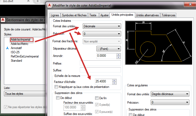

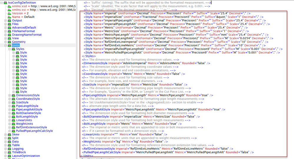

Here is an approach to output isometrics in MM units from a project defined in INCH.
For that I created a new iso style "Final_ANSI-C metric" which is the copy of the style "Final_ANSI-C"
In this new style I modified the "IsoConfig.xml" file to apply the MM parameters for the nomenclature and coordinates part
In the "Iso.dwt" file I modified the "AdskIsoImperial" dimension style to apply a metric dimensional unit and a unit scale factor of 25.4 to it.
This setting is only an approach which may require some readjustment.
See Screecast
I attach the file of the iso style "Final_ANSI-C metrique" which is in French.
