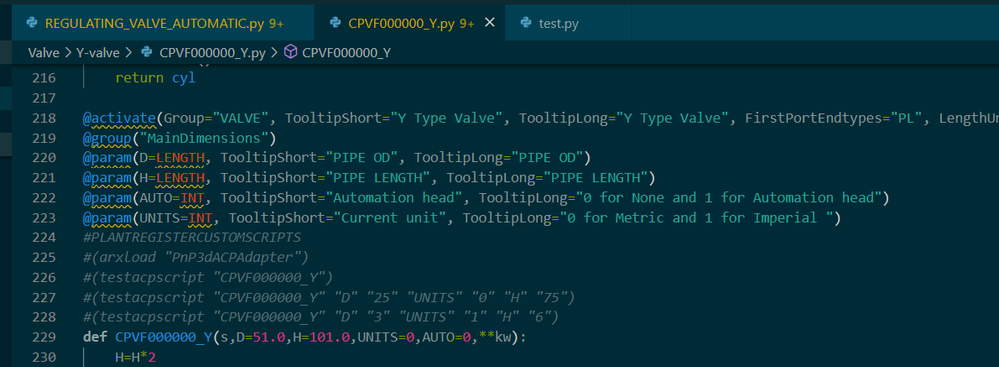

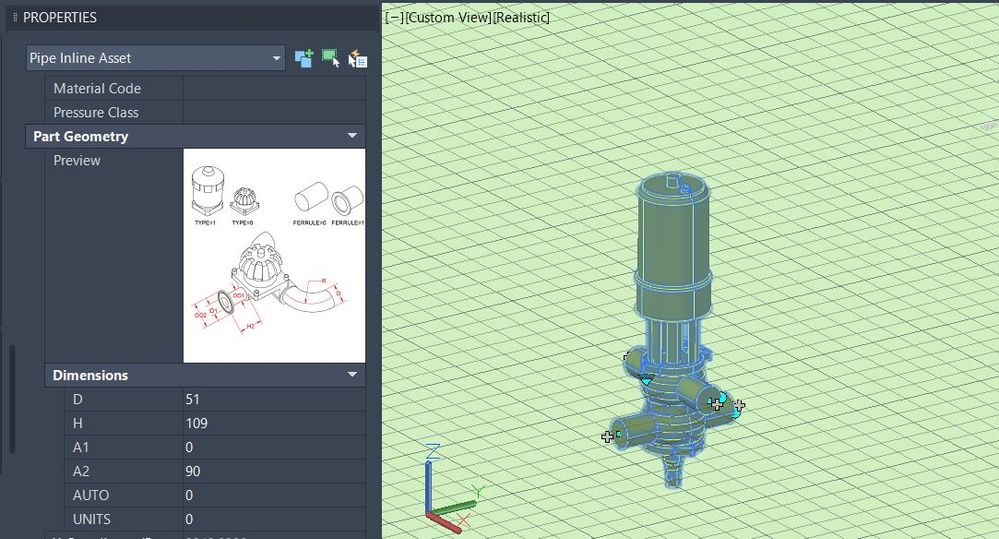

I found the solusion. Just named your valve something like CPVF000000_Y with CPVF000000 is the existing default valve (many others name you can choose) and _Y is your custom valve name. The software will understand that this is parametric valve and allow you to edit it.
