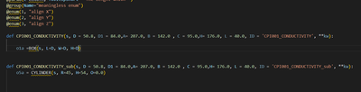

Hi all,
In the custom equipment that was created with python. In that, I want to create a multiple "def function". However, have some errors. I tested this working, but only geometry in the first def function woking. you can see a snapshot below.
 Is there any solution for this?
Thank you for help

The main function have to put below @Anonymous, @Anonymous decorator, other funcion above them. Then you can call them in the main function, check out the sample function in the picture.

traiduong014969
Thank you for sharing. It working so good
