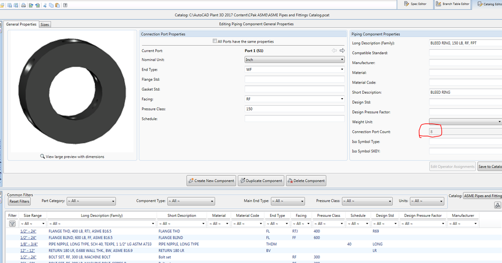

We have a 4" bleed ring,  with Four (4) 3/4" drill holes.   A total of 6 ports.   I have tried to make this part in the catalog but it has a limitation of 4 ports.
So I tried custom parts from the Ribbon bar.  Again the 4 port limitation.   I tried to create if from a custom block and when I use convert parts,  I ran into the 4 port limitation again.
Is there a way I can make this bleed ring.
Thanks for any help.

No cut sheet it simply states in their  specs  "ASME 150 rf/ff bleed ring, four drilled bleed holes and 3/4" FNPT thd taps, CS hex head plugs, Cs body."
  I was planing on building the part with a (2)  bleed holes  at 15 degs from the 0 and 90 position,  or one at every qua.  depending on feed back from the engineer.

You can put as many ports as you want on a block based part just type the number, the drop down only goes to 4. I put 8 on my sample bleed ring - see below.
