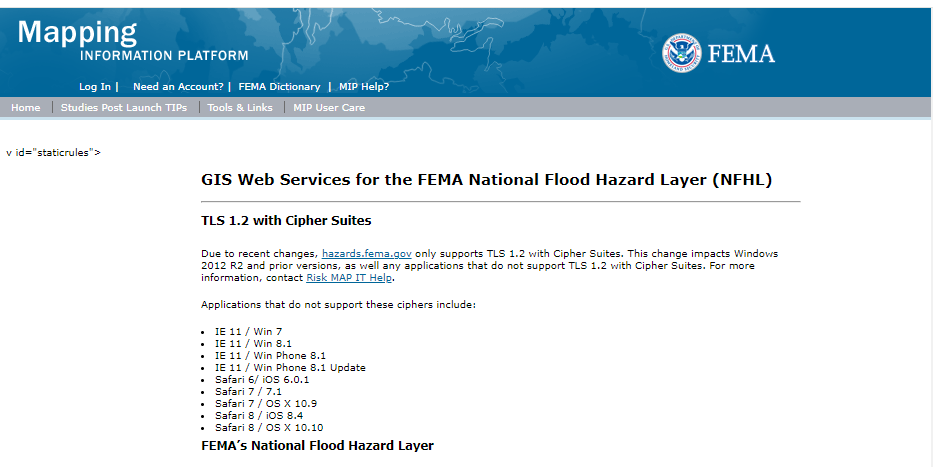

ChicagoLooper
Hi @dean.borcik
Yes, you can make a 'connection' but you can't connect to the data you want.
1. Go to the FEMA page then scroll all the way to the bottom.
https://hazards.fema.gov/femaportal/wps/portal/NFHLWM
Image-1Image-1

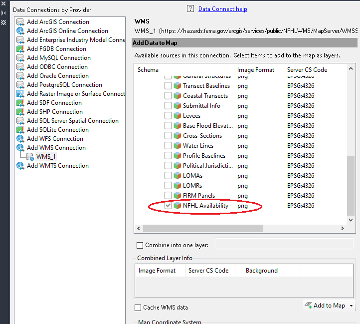

2. Copy the highlight address and paste it in the Add WMS Connection of the Data Connect Palette.
Image-2Image-2
3.When you're connected, be sure to check the box at the bottom. It's the only layer(?) that can be added.
<<How ironical. It's named NFHL Availability>> LOL
Image-3Image-3
