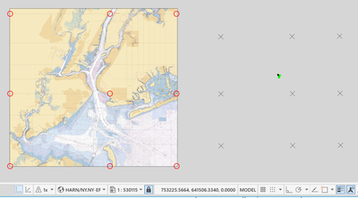

The NY 2024 150 DPI.jpg has nice 1 minute grids, so I created COGO points with these:
-74°18',40°47'
-74°00',40°47'
-73°48',40°47'
-74°18',40°36'
-74°00',40°36'
-73°48',40°36'
-74°18',40°26'
-74°00',40°26'
-73°48',40°26'

I used ADERSHEET because that's what I have.  It got close, especially considering I usually use ALLIGN and two points.  I had a final MOVE in my project area and it is dead on.  I've attached a screen capture.  Thanks everyone so much for your help.  I now have something that works.  I still don't understand a lot.  Is there a good reference book or online course that you might recommend?  THANK YOU AGAIN!!!
