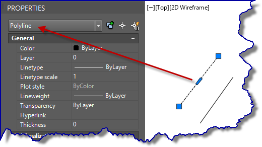

Alfred.NESWADBA
after you finished MAPCLEAN (with the result 0 0 0), select one of the objects that you try to use for creation of the topology, look to the property window (if not active then press <CTRL><1> to get it activated) and let us know what object type is listed there.
- alfred -
Alfred NESWADBA
(not an Autodesk consultant)
Message 5 of 17
polyline
