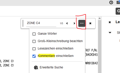

NO, read your help [F1] Value1 creates Comments, value0 not. Value 1 is what you want - change it back.
Nothing helped so far...
Your original settings are good, your posted .PDF IS SEARCHABLE !
But think about that  .SHX text will not convert ro PDF Text objects and PDFSHX will create "comments",
you have to set up your PDF program to SEARCH IN COMMENTS TOO
For example:
PDF-XCHANGE - it is a default setting
ACROBAT READER DC (and other products) - You need to enable it
NOTE: Since version 2024 you can set up PDFSHX(2) to create invisible PDF TEXT elements, instead of comments!
This way, it is independing of the search-in-comments-setting.
