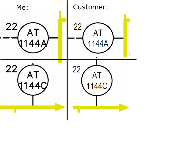

First of all i haven't been using AutoCAD much in a long time.
So i'm going to work in tandem with a Customer doing simple 2D drawing. I have a newly installed AutoCAD LT, i believe they have a full version AutoCAD. So all i did was to open the drawing i did no editing. And some of the text inside a block seems to be a bit to big. They are using Ariel Narrow,  it is a standard font which i believe should be included. Do i need to download this pacific font, and where would i find it? Can a shadow of a old Block from a old drawing be messing with current block?  It is vital the drawings remain the same.

The font size should not be changing. Arial Narrow is a standard windows font.
Can you post a screenshot of what the customers sees and what you see so we can compare them side by side.

But the more i look at it i seam to be missing Arial Narrow. If i make a new drawing i can find many different Arial types except the Narrow. When exporting to PDF the error messages indicate missing SHX Text.

Ask them to use ETRANSMIT to send the drawing to you and get them to click TRANSMITTAL SETUPS and make sure the INLCUDE FONTS box is ticked. That will create a zip file which includes the font they're using. See the image below.

So compering my font list and my customers font list. it is different i have fonts they dont have and they have fonts like Ariel Narrow i don't have.  How can this be? There must be a solution.
Message 8 of 13
h_s_walker
Arial Narrow is a windows font. You can download it from the web. A quick google got the following site

@Anonymous your PC, your fonts, your task to ensure they are all included.
Assuming you looked in the correct place for Arial Narrow (C:\Windows\Fonts) and assuming the spelling difference (ARIEL NARROW) does not mean they used a completely custom option that they need to share with you.

Didn't know AutoCAD wold get fonts from windows i was fullyfocust on fonts in AutoCAD and in shx format.
Thanks that is a relief.
