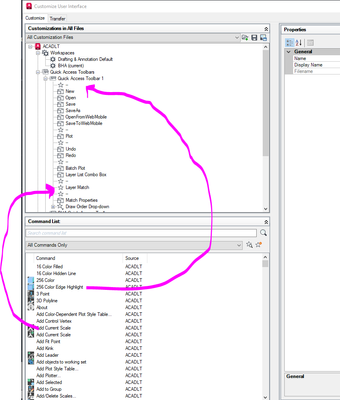

Any reason you don't want to use the 50+ possible icon toolbar right there at the top of the Ribbon called QAT that you can add anything you want to anytime and it stays there all day long? I have it positioned at the bottom of the Ribbon where I like it to be:
That you can drag and drop your custom commands created in CUI command's pop-up section called COMMAND LIST to literally with your mouse button
or if that command already exists in the Ribbon, you can right-click on it and have it moved to that QAT toolbar
and you can arrange the locations of the items in the QAT with a drag/drop while in CUI command

@ichisdeno from an old post on here
1) Open the CUI (type CUI at the command line)
2) In the top left window, highlight your workspace
3) In the top right panel, click "Customize"
4) In the top left panell, click the "+" symbol next to Quick Access Toolbar
5) Put a checkmark in the box
6) Click "Apply" and "OK" at the bottom of the CUI palette.
Or if you are talking about the toolbars at the top at the command line type RIBBON
