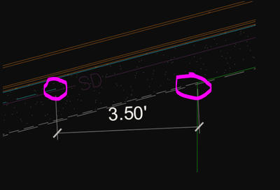

I must be missing a setting somewhere which causes a dimension to automatically rotates if I move a grip of one of the extension lines.  The 3.50' dimension needs to be parallel to the line with "SD" in it (see below).  Is there a setting I can change so this doesn't happen?

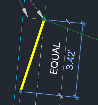

Moving grips has consequences: in your screenshot, the dimline now aligns with the two points I highlighted, which tells me you opted for the incorrect "dim" command to use here.
Re-dimension using this command correctly instead (see LINK from HELP), then you can move grips after the fact anywhere you want without moving the dimline's original angle https://knowledge.autodesk.com/support/autocad/learn-explore/caas/CloudHelp/cloudhelp/2022/ENU/AutoC...

Here you go...

@pendean is right, I was misunderstanding your question
You should for this case indeed use the 'dimrotated' command.
Note though that you are not giving the length of the yellow line in this case.
