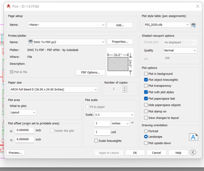

h_s_walker
Can you post a screenshot of your plot dialog box so we can see the settings

alaina.marie222
Hi @h_s_walker,
This is my dialog box. it shows that the drawing is set to CTB because that is whats showing up. Does anything look out of place?

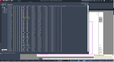

alaina.marie222
1) layer command
Message 14 of 26
