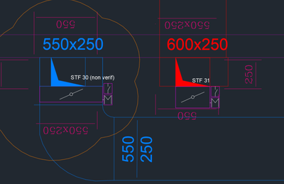

Message 12 of 15
christian_serena
Agree, however I am referring about attributes on the drawing, not on the "edit attribiute" window.
In this shot from my drawing you can read "STF..." that are attribute which text I need to enlarge all at once, visibile in my drawing and not in yours

Message 14 of 15
pendean
Community Legend
Community Legend
Greetings @christian_serena
Looks like you need to upgrade from LT to full AutoCAD, to gain access to this alternative command to do the manual edits you wish to do
In the meantime... Open a support case with Autodesk if you are on subscription to seek out Autodesk Support's help:
