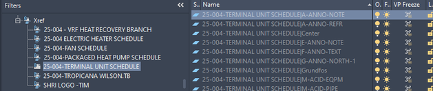

I am using 2023 version of AutoCad.
I have xref several schedules and one of then is not showing up in the view port. The attached drawing will have Electric Heater schedule  at the bottom left hand corner. I have a viewport on the top right hand corner of the paper space and one can see that schedule is not visible. All xrefs are in M-ANNO-NOTE Layer.
Can anybody solve my problem?
I have attached the drawing.

well, if those schedules are xrefs, then the layer names are all different because they're prefixed by the xref dwg name:
paullimapa_0-1766965386485.pngpaullimapa_1-1766965400643.pngpaullimapa_2-1766965412317.png
Also be careful on the layer you place those xrefs.
You have most of those xrefs placed onto layer: M-ANNO-NOTE
But that one 25-004 ELECTRIC HEATER SCHEDULE is placed on layer: E-ANNO-NOTE
So you can also end up VP Layer Freezing those Layers and the entire xref would also no longer be seen in that Vport.
So you may want to consider placing all xrefs onto Layer 0 which typically is not frozen.

If you double click in the viewport that you want the table to show, then open the layer manager, find layer xref:25-004 Electric Heater Schedule|M-Anno_Note and it has VPFreeze enabled. Uncheck it. This happened because the layer inside the xref has NewVPVreeze enabled. So when you created a new vp, the layer was automatically frozen.
None of this would have happened if you simply put the table xrefs in paperspace where they should be. Model space is for modeling real world objects. Annotations should be in paper space. (Although some may disagree with me. 😁)

Don't get Layer Freeze confused with VP Freeze.
These are two different columns to control Layer visibility.
In Model tab, only the Layer Freeze column shows up.
But in Layout (whether outside of a Vport or inside a Vport) there's both a Freeze column as well as a VP Freeze column.
Now if you don't plan on using the Vport Freeze feature, then just make sure all Vports in the current layout has all Layers VP Freeze set as VP Thawed. Here's single line of lisp code to do this:
(command "_.Vplayer" "_Thaw" "*" "" "")
This is how it looks like when it executes:
Now all Vports in the current layout will have Layer VP Freeze thawed.

Yes, that other infamous Layer Vport control New Vp Freeze
@apanbasu To make sure you see all these Column headings in the Layer Properties window, right mouse click over any of the column headings and select to toggle them on/off:
