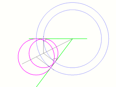

Hi!
I've had this problem for a while and can't seem to figure it out myself, so here goes:
I have two lines and need a circle tangent to both, but only to one point of each line. If I've got it correctly there should only be one solution to the problem no matter the lines or their angles or so on.
Thanks in advance!

Here are the lines in question:
Lines.dwg is both lines with the tangent points marked.
Lines2.dwg is somewhat the intended result, but with intersections.
I don't have the radius of the circle or any other variable.

[Written before seeing Message 4's drawings]  There will be a solution only if the two specific points are the same distance from the intersection of the Lines [or virtual intersection, if they don't meet each other].  There's a [white] Circle tangent to both [red] Lines at both [green] Points in the left arrangement that fits that description.  But that's not possible in the other two, in which the [dashed white] Circle is tangent to the lower Line at the lower Point, and passes through the other Point, but clearly cannot be tangent to the other Line.
There would be an Ellipse that would be tangent to both Lines at both Points in the middle and right images.  Finding it would be a challenge in the middle image, but easy in the right one where the Lines are perpendicular.

How would I go about finding that elipse?

That's a real challenge, if even possible definitively, when the Lines are not perpendicular.  In fact, there are an infinite number of solutions.  My approximation is tangent to one Line at one of the Ellipse's quadrant points, which limits the solutions, but maybe that should not be assumed.  And even given that assumption, that tangency condition could be at the Point on the other Line instead, with a different Ellipse.  Even where a Circle solution is possible, there are an infinite number of possible Ellipse solutions at different aspect ratios, with an axis along the angle bisector:
I think at the very least you would need to come up with some more specific criteria, such as that it needs to be tangent at a quadrant point, and if so, at which of the two Points, or something.

I would use a spline to draw your curve that is tangent at both ends at the indicated points.  (screencast) .  Although, in order to construct a "circle" that is tangent to both lines at specific points, the two points must have a perpendicular line that intersects at a line that bisects the angle of the two original lines.

There can be no solution to the exact problem posed.  In order for a "circle" to be tangent to be 2 straight lines, the points of tangency need to be "always" the same distance from the vertex formed by the two lines.  Ask Kent has stated, there probably an infinite number of solutions involving ellipses.

I do not think that there are an infinite number of ellipses that will satisfy the requirement. One method to approximate the ellipse would be the following. Note, I would draw a picture but I'm away from my cad computer for a couple of days.Assume the two tangent points are labeled A and B. Divide the t uvwo line segments by 10 and draw lines from the 1st point on the line containing A to the 9th point of line with B. Then draw a line from the 2nd point of A to the 8th point of B. Repeat the pattern and the result should approximate an ellipse.
Another way to proceed is to create a spline as suggested. I would use the CV method and place a CV at A, then a CV at the intersection, and the 3rd and final CV at B. This would yield a degree 2 Bezier spline tangent to the 2 lines.

This thread has evolved to a couple of sub-topics.  Regarding an elliptical ‘fillet’, I agree with @Kent1Cooper  that there are infinite elliptical arcs that could be tangent to those two points (infinite hyperbolic arcs as well if that were of any interest).
As pointed out by @leeminardi , a tan-int-tan degree 2 spline can create the blend as a Parabolic arc – and only one such parabola exists (Incidentally, the connection of division points approximates a parabola).  An elliptical arc is created if the weight of the middle CP is reduced from 1.0.  Hyperbolic results from a weight greater than 1.0.

Thanks to everyone who answered! It seems I will either have to use an ellipse or parabola or change my design but all answers were great. I've learned a lot too.
