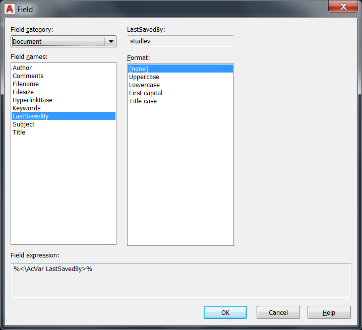

Hi @Anonymous,
Thank you for joining us for Answer Day!
As an alternative, could you use the Field variable "LastSavedBy"?
