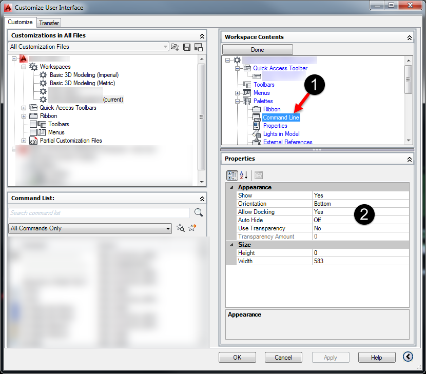

You can also retrieve it by editing the CUIx file.  Within the CUI dialog, edit the current workspace.
Select the 'Command Line' palette, and verify the settings in the area designated below as "2".

Years later, this helped me to get my command line back. It was offscreen at the bottom of my monitor. I changed the orientation from floating to bottom and it reappeared at the bottom of my Autocad window. So I can verify that this tip works for Autocad 2021. Thanks.
