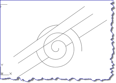

Hello! I have been drawing spirals in 2D as well as straight lines, as can be seen in the image below, and I needed to trim the lines in between the spirals. In the beginning, everything worked perfectly; however, now I would only allow me to trim straight lines, and not the spirals. Can you please explain me what I have accidently pressed that it stopped working? Many thanks!Снимок экрана 2016-11-25 в 1.14.00.png

For me it is working, can you upload your drawing + let us know which AutoCAD release and service pack you have?
What does the command line tell you during selecting the cutting edges or during selecting the objects to trim?

AutoCAD 2014 can run command _TRIM on spiral and lines. just tried it.
So please show your drawing + let us know what AutoCAD tells you when you select cutting edge/object to trim...

Hello! Many thanks for your help! My AutoCAD version is of 2014. When I try to trim the line, it says "Select object to trim or shift-select to extend or [fence/crossing/Project/Edge/eRase/Undo]:". It seems like it could not see the helix as a line because it is 3D. Before it worked perfectly for me, as you can see on my project; however, it stopped working for some reason. I am going to attach my file below. I can see that it work for you, so probably I have accidentally pressed something.Many thanks again!
from first post:
If that is changed from 2D to 3D then change it back:

Thanks for your help! What value should I put into the turning height? When I put zero, it did not change anything
Message 10 of 16
When I go into 3D mode, it shows me that a helix is in 3D, but I work in 2D. I thought that maybe this was the reason why it does not work for me in 2D
Message 11 of 16
I have changed the turning height, so now it is in 2D; however, it did not solve my problem with trimming. I have no idea what can be the reason for it not to work
For me it worked after changing that value.
Can you create a screencast video (>>>click<<<) so we can see what exactly is happening with your AutoCAD?

I don't see what AutoCAD tells you when you try to select the spiral, the command-line seems to be only one line high and so messages like "invalid object" or something like that (which is now needed to identify the reason) are hidden/invisible. Is there any chance in AutoCAD for Mac to make the command-line higher or to switch to the command-line as separate window (in AutoCAD for Windows it's just needed to press <F2> to get this window).
What happens when you use copy & paste to copy the geometry (spiral and lines) to a new drawing and try _TRIM there again?

Add a point with PEDIT where you want it split. Then try trimming again.
