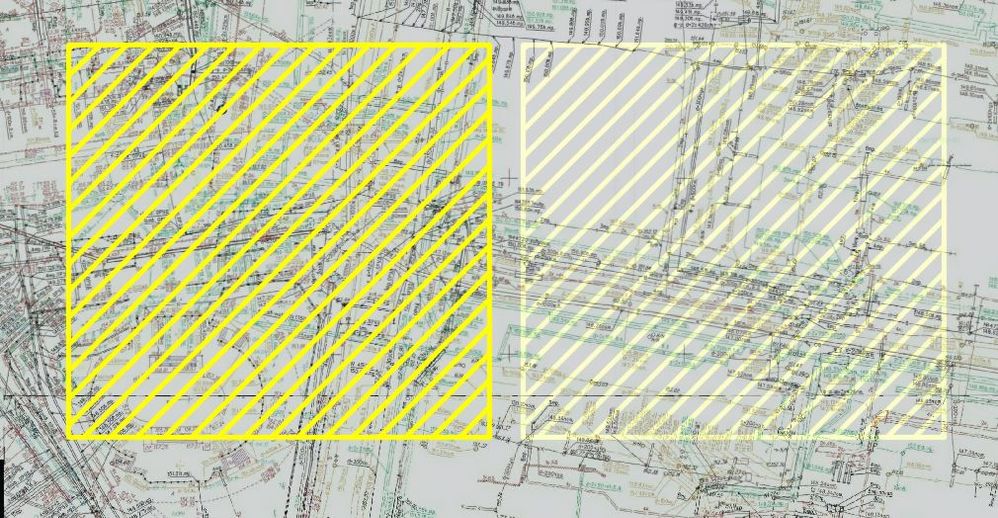

tboehler
There is also a tranparency setting to the layer the image is on (or by entity).  This can show items under the image (can be done to most entities as well).   You can also fade or add brightness to the image to lighen it - letting the important info stand out.  These are different then setting a background tranparency to the image.  I thought this may give you alternative process - the image background is white anyways.
See image - items on right are under image - items on left are on top of image.Capture.JPG
