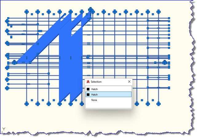

I started to dive into the single files, starting with "1ST FLOOR.dwg", what I see is that:
Above your real geometry I see a lot of hatches like that:
...and worse: if I select this hatch and see it's borders, I get this:
So you have outside the base geometry a lot of very complex hatches, which are even not needed, are they?
- alfred -

Message 32 of 50
Alfred.NESWADBA
>> I can't see these hatches. I don't know why
Open the "1ST FLOOR.dwg", activate modelspace and zoom extents. Then press <CTRL><A> to select all objects ... and be surprised ...
If you don't see geometry outside your "project area" then please start command _ABOUT and show me a screenshot of that dialog.
This is what I see doing the above steps ... (in AutoCAD 2022 and 2023 you see more, but in 2021 you see object selection at areas you don't think objects are placed)
Also there exist geometry on the DEFPOINTS layer, and even worse these are annotative blocks.
If you want objects to not plot, then create a new layer which has the property "No-Plot", but do not (never) use the DEFPOINTS layer, this is reserved for AutoCAD internal use.
And if you want objects to not be plotted, why then making them annotative?
- alfred -

Message 34 of 50
Alfred.NESWADBA
did this workflow:
  • copied based dwg and dwg's for floor 1 to 4 into a new folder (so when I open the base drawing he just finds 4 referenced dwg-files ... just for testing)
with these 4 files I did
  • command _ERASE with option _ALL and then option _REMOVE and a window selection around the "real" geometry (this removes the dead ones outside the project area)
  • command _QSELECT for all objects on layer "DEFPOINTS" ==> let the command select these items and then delete them
Then close and save these dwg-files, open your based drawing and run _PUBLISH.
This makes _PUBLISH a lot faster, so you'll need to execute this for the other floor-files and I guess you get back a valid speed for publishing.
This is my dialog for _PUBLISH and it's options:
- alfred -
