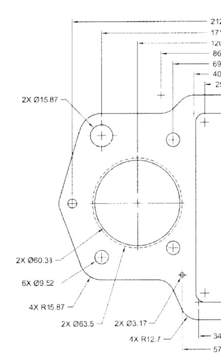

New to autocad struggling with homework
michaelpscrivener
hi yall, first semester autocad student and new to everything about autocad. Really struggling even getting started as all of this class is online and I learn more in person and doing examples with someone. My current assignment is this and i'm struggling even getting started. How would you guys start something like this? I know its different for everyone.

paullimapa
Since you learn better in person, why did you enroll in a class on-line?
You should really enroll in an in person classroom.
Then you can ask the teacher questions directly and learn along side other students.
But to start off, the following items you need to know really is not necessarily involving AutoCAD:
1. Graphically speaking the exercise is made simple because the left half is exactly the same as the right half. So all you have to do is really draw half of the exercise and then you're done:
2. You'll need to know how to read the instructions already provided in this drawing:
a. The horizontal & vertical lines with arrows at both ends and a number in the middle represents how far apart an item is from another and this is typically called a Dimension. For example the outer most vertical Dimension on the right of the drawing shows number 158.75. This tells you how tall this item you are drawing needs to be.
b. An arrow pointing to a Circle with the following formatted text at the end: #X 0##.## tells you how many items there are in this drawing matching the same criteria and with the size of the Circle's Diameter.
So for example:
The 2X tells you that there are in this drawing a total of 2 Circles matching the following criteria:
The 060.33 (that's a zero before the number) tells you that the Diameter of this Circle is drawn at 60.33 units.
c. An arrow pointing to an Arc with the following formatted text at the end: #X R##.## tells you how many items there are in this drawing matching the same criteria with the size of the Arc's Radius.
So for example:
The 4X tells you that there are in this drawing a total of 4 Arcs matching the following criteria:
The R15.87 tells you that the Radius of this Arc is drawn at 15.87 units.

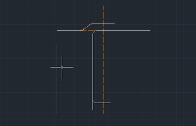

TheCADnoob
You are correct there are many ways to get this done, so the following probably is not the most efficient. Its often best to just build out all your construction lines so that you can make drafting easy. That said... i didn't do that in this exercise. (but not doing it first let to making mistakes along the way)
Some helpful things are using different layers and using your OSNAPS. You need to know how to use those.
Below is where you can find OSNAPS and an image of the OSNAPS i use.
It looks like you can take advantage of bilateral symmetry in this one. I drew a center line on a layer that isn't my main drawing. Then, I started drawing lines at full length and then moved them by the midpoint to a line that I will later use to mirror the whole object. (If you use point filters and some of the other overrides it could make that process easier, but I'm trying to show you a way you can start to work without knowing a whole lot.
Once i have the line at full length drawn I grab it by the mid point and move it.
Next I drew another line in the same manner.
Next I drew the vertical run
Then I mirrored the inner boundary geometry using that vertical run mid point.  This part can get confusing if you use the wrong dimensions. (This is why its better to build construction lines first)
Next Ill begin working on some of the fillets. Here i prefer to use CIRCLES and the TRIM command for ease of seeing whats going on. Here I'm going to use the tan tan radius version of the circle command.
Begin Trim
Now ill use mirror to copy that part to the bottom.
Next I drew a line to indicate the distance that will be covered by the fillets. (ill be using circles here instead of the fillet command.
I drew the circles and then used the quadrant OSNAP to move them by their quadrants to the locations seen in the image.
Next i began the line command. In the line command i hold CTRL + RIGHT CLICK to bring up the snap override menu. Here i will draw my line tangent to both circles.
Now its back to the trimming
Now I created some more construction lines to help through the next few steps.
I drew some more construction lines to help.
For the next circle i didn't see the necessary dimensions so I used an estimation. I assumed that it would likely be between the who size of the circles so i used 6.35 since its between 3.17 and 9.52... Read you directions to make sure they didn't cover that dimension else where.
Then again.. there were no dimensions for that exterior radius. say so i just assumed the exterior circle would be twice the radius of the smaller circle. and moved on. Again look over your notes and the rubric for this to make sure they do not indicate what to do there.
Next i drew another circle and moved it using quadrants.
Then, I utilized the tangent between the circles line again.
Then some more trimming
I started filling in the other geomtery
You can get different line types from the line menu
If you need to change the line type after that can be done in the properties pallette as well. (CTRL + 1 , or right click on the items and select properties).
The i continued to add gemotery.
A helpful override to use is the from override. This allows you to move an item as though it was from another location. This helped me make short work of moving items around to the proper dimensions.
Next I made another assumption (third one so far by my count). I assumed that the distance of the small circle is the same as the one from the bigger circle at the top. I didn't see that dimension called out.. though i could have overlooked it.
I started back with some of the boundary work
I used the line command with the tangent overrides again
Ill use it again on the lower circles.
Go around trimming everything up. Notice I trimed everything up to the center symmetry line.
I turned off the construction line layer
Now just mirror,
I'll save all the annotations as an exercise for you.

This is the kind of drawing where I would tackle it like how I would assemble a jigsaw puzzle.
I would first start with the outside boundary because the inside objects can be drawn anywhere and then moved inside the boundary afterwards.
So let me get you started with this:
I hope you know how to start a new blank drawing selecting a template file like acad.dwt which should give you the setup you need to enter the units of measurements and angles in degrees as shown in the drawing.
Since this is CAD, you can really start the drawing process anywhere.
But as I initially stated, I would start at a corner where the drawing shows most of the dimensions.
This would be at the upper right hand corner:
I've circled all the outside dimensions in red which you'll use to complete the outside boundary.
In addition you'll need a couple of inside dimensions in green as well as the angles in purple with the calculations based on how you would enter them in drawing a line.
So start the LINE command from anywhere on the graphic screen and with ORTHO toggled On (F8) just enter 150 and then ENTER (2x) to finish the LINE command.
Next start the OFFSET command and enter a distance of 35, select the LINE and select a point below the LINE & then press ENTER to complete the command.
Repeat the OFFSET command again and this time enter distance of 72 selecting the last LINE you drew and pick another point below that and then press ENTER to complete that command.
So now you should see 3 LINEs on the graphic screen:
Now to draw the 15 degree angle LINE from the upper right corner, start by using Object Snap End and select the end point of the top LINE on the right.
Then toggle ORTHO Off (F8) and then enter any distance like 100 and then hit the lesser than symbol on your keyboard "<" this tells AutoCAD you will enter an angle which in this case would be 180+15 = 195 and hit ENTER 2x to complete the command:
You've just learned how to draw an angled LINE.
Next I would draw the vertical LINE from the upper right corner down 35 units to meet with the end point of the 2nd LINE from the top.
Then OFFSET that vertical LINE 72 units to the left:
Now that you've got that 2nd vertical LINE to the left you can now draw the that down 15 degrees from the top LINE and this time the angle is 270+15=285:
Now enter the FILLET command to get rid of the excess the two angle LINES:
Now draw the far left vertical LINE connecting the top to the bottom LINE:
To get the lower left 45 degree angle LINE, use the CHAMFER command and enter the Distance for both as 28 units then finally select the far left vertical LINE and the bottom horizontal LINE to complete the 45 degree angle LINE segment:
You now should be able to use the same commands to complete the remaining outer boundary drawing.
