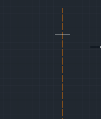

You are correct there are many ways to get this done, so the following probably is not the most efficient. Its often best to just build out all your construction lines so that you can make drafting easy. That said... i didn't do that in this exercise. (but not doing it first let to making mistakes along the way)
Some helpful things are using different layers and using your OSNAPS. You need to know how to use those.

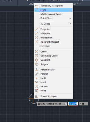

Below is where you can find OSNAPS and an image of the OSNAPS i use.
It looks like you can take advantage of bilateral symmetry in this one. I drew a center line on a layer that isn't my main drawing. Then, I started drawing lines at full length and then moved them by the midpoint to a line that I will later use to mirror the whole object. (If you use point filters and some of the other overrides it could make that process easier, but I'm trying to show you a way you can start to work without knowing a whole lot.

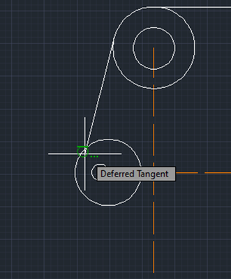

I drew the circles and then used the quadrant OSNAP to move them by their quadrants to the locations seen in the image.
Next i began the line command. In the line command i hold CTRL + RIGHT CLICK to bring up the snap override menu. Here i will draw my line tangent to both circles.

Then, I utilized the tangent between the circles line again.

A helpful override to use is the from override. This allows you to move an item as though it was from another location. This helped me make short work of moving items around to the proper dimensions.

I used the line command with the tangent overrides again
Ill use it again on the lower circles.
