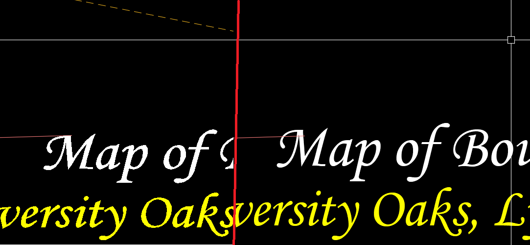

wasnt sure what to title it but ive noticed for some reason when moving anything especially text that ill move it to one spot and itll slightly move lower.
all my settings to control grid or snap spacing all that is OFF. everything moves smoothly its on a 4070 so i dont think its the graphics card
the first is MTEXT being pretty blatantly different from the spot i selected.
second is a grouping shown on line, then it slightly moves lower.

Sorry, but your screenshots don't offer anything meaningful. I believe you when you say you're having issues, it's just those screenshots do not adequately illustrate where the 'movement' is occurring.
I'm sure you can see, and know, bad results happening, but the forum can't, so you'll need to upload better screenshots (or make a video). Help the forum so the forum can help you.

i thought the screenshots were pretty self explanatory. You seem to be the only one having the issue. It shows on the left how I'm moving something and where its lined up while in the move command. Then I'm not moving the mouse at all and clicking exactly where I'm trying to put it. And on the right its the result with mouse still in the same place after the end of the command. Sorry   And idk how to post a video.

I didn't get what you were talking about at first, either.  Studying the images further:
In the images, I assume one side of the heavy red mid-line is "right" and the other is "wrong," though it's not identified which is which.  I think it's the right side in ex2, because of the boxed-in bits that are apparently pointing out what I assume must be the "wrong" result.  There is a difference in Y-axis-direction position between certain things in one side vs. the other.
In ex1, I assume the purplish-brownish line at upper left is a constant, and gives something to compare the position of the big M in the text to, to see the difference.  But if the right side is "wrong," it's higher, rather than lower as described, so maybe it's the left side that's "wrong."  And in the left side, what looks like a drag line is visible at the top, apparently in mid-command, so what can it tell us?
In ex2, if the boxed-in bits in the right side are "wrong," there's a very much smaller Y-coordinate difference from the left side [but there is a difference] than the difference in ex1.
But if my interpretation of what the images are meant to show is correct, we're still missing the more crucial parts that even a drawing file might not answer.  We can't tell what you gave it as start and end points for the Move displacement, what your Osnap setting was [if any], what Coordinate System and/or view direction you're in, etc.  That's why a video might be the most helpful thing, preferably including the UCS icon and enough of the Command line to see what commands/options you're using.
