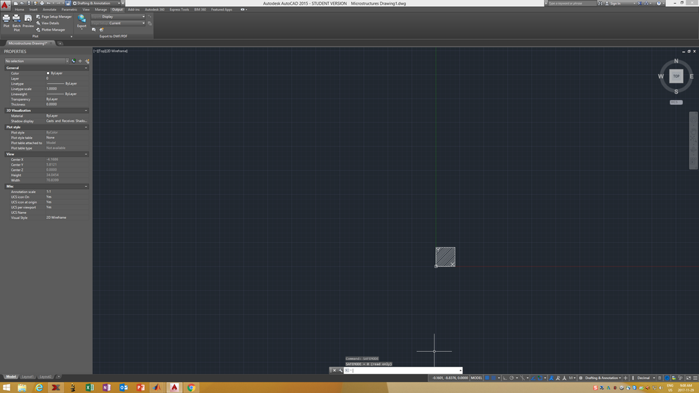

Thank you everyone for your answers so far. The versions I have been using are all Autocad (not LT so far) student versions. The lisp functions do not seem to be available. Could it be that the free student version does not have this set of commands? Has anyone gotten these commands to work on a student version?

1.) Please show us what happen when you try that:
     command: (setenv "MaxArray" "200000")
2.) What do Acad answer if you type-in SAFEMODE ?
(copy the last lines of Textscreen [F2] or make a Screenshot)
Sebastian
Message 8 of 9
I don't know what I was doing wrong before. I have attached screenshots. Now, when I type:
it works. Thank you! The program doesn't recognize setenv on its own (it tries to recommend other commands like setvar.
