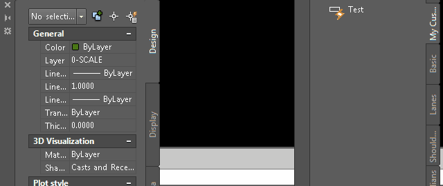

click on the that tool and go to properties under general verify that the color is set to bylayer (not byblock?)

Hi Moshe
we have checked and the colour in the properties is set to ByLayer as it should be. None of the delegates have changed this setting.
Also the current drawing colour is set to ByLayer.

After adding the block to palette, change it's properties under layer  to --use current
