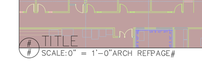

I'm attempting to use the sheet set manager as a tool for dragging and dropping standard details into a drawing. As a standard, we typically don't use sheet sets for anything. I've created a new sheet set, defining the "label blocks for views" as the .dwg wblock that is our standard drawing label, but when I insert a model view, it doesn't come with a title block at all.
I then created an example sheet set where the "label blocks for views" definition is pre-defined using a default title block. Upon dragging and dropping a model view into the drawing, the same thing happened... Not sure at all why this is happening. Scale maybe? Any help will be much appreciated. Thanks!

Here's a basic sheet set with the drawing title block that should be attached to each newly inserted model space view.
Message 5 of 32
john.vellek
Hi @bhuhn,
If I understand your question, I think you are expecting more than what this tool is designed to do.
I took your Sheet Set and made sure that  Label block for views was set to "drawing title block" by rt-clicking the Sheet Set in Sheet Views.
Then in Model Views, I added some of my drawings and placed one of my plans to a new layout as a model view by rt-clicking and selecting "Place as View". The resulting model view was placed on the new layout and included the View label.
This is working as designed. Are you expecting it to add something else?

Nope. That is exactly what I did - only no title tag was included when I inserted my view.

Alright - so for the sake of future productivity, I'm trying to make the jump to having our company use SSM for all drawings. So I'm currently working out a test sheet set for everyone to eventually use as a template. I can't seem to get any of the callouts to work. I've attempted to insert a callout exactly as directed in Sheets Happen!, only no callout appears on the screen. The issue is not the block itself, as I've tried this with a few different blocks. Basically, I have the sheet set mapped to a number of different callouts - none of which show up on the screen. There is no error message, just "_callout" in the temporary command line history. Let me know if you have any ideas on a diagnosis...

Thank You. I am also having a randomly recurring issue where if I close out of a sheet set and later reopen it through SSM, all of my automated view labels loose the datalinks for the fields and just show the default field... most of them just a series of "#". I can put in the labels manually and the link is fine, but obviously I'm not too keen on having to replace all of my view labels every time I reopen a layout.

The ### means that it can't connect or find the linked data. Is the DST stored with the files or in a different location?

The default callout tag worked, but not our custom tag. Title block works fine other than the issue mentioned in my last post.

The issue with the callout blocks though... not sure why this is happening. I re-made a callout block and it worked just fine, only the text justification was off-center. I went back into the block to change it and now it doesn't work... same issue where it just doesn't insert into the drawing.
