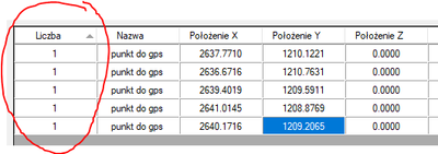

Hey, i have such issue: In my project i have to insert manulally lot of points in Acad - i use comand "_point", and insert them one by one manually on my drawing.
Then a use command "_EATTEXT" to extract those points to txt/CSV with their X/Y/Z coordinates. Everything works fine, but every point has it`s own number "1"  😞
Is there any method that when I insert point on my drawing, Autocad would show me not only the point, but point with number 1,2,3.....n, and then those specific numbers will be shown on the extract list and in my txt/CSV file?

I`ve read plenty of such topics: all of them refers to IMPORTING some data into Acad which them generete points with some numbers.
I think about making some block of point and text, but have no idea how...

the idea is: I have a map of a road - on this map there is lot of places which i have to find in real enviroment.
In Acad I insert a "_point" in every place i`m interested and then export those points to CSV/txt with command "_eattext". Then in Excell i have list of those points with X/Y cooridnates - i put those points im my GPS and go outside and find those points.
But all of this points have number "1" and i have to manually overwrite on my new map all points...
ed: I tried making block of point + attribute and doing _TCOUNT but TCOUNT does not work with blocks....
