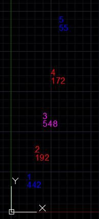

Here's a modification to my post #4 that gives the TEXT command twice to enable two lines of text.  I tried using the MTEXT command but had difficulty getting it to accept a new line in a script.  I was able to do it with the TEXT command by using the unicode \U+000D for a carriage return.  Note that 0.5 is subtracted from the y coordinate of the second text command to offset the second line of text.  The 0.4 is the text height.Capture11.JPG
Here is the Excel formula to fill-down  (spaces are critical).
=CONCATENATE("point ",A2,",",B2,",",C2," ","text ",A2,",",B2,",",C2," ",0.4," ",0," ",D2," \U+000Dtext ",A2,",",B2-0.5,",",C2," ",0.4," ",0," ",E2," ")
Again, copy the contents of column F to Notepad and Save As a text file with the extension .scr to run with SCRIPT.
